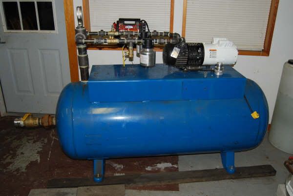

    A friend helped me put this together; and by "helped" I mean he scavenged most of the parts and put it all together for me.
    Enjoy!

    How many gal. is that?

      Yeah, as soon as I bring it home. It's 96 gallons

        About how much do u have invested in that? if u dont mind....

            The hose was about $85.00
            The tank was a gimme, as was everything else. My buddy is an HVAC tech and we traded rough cut lumber left over from when I had a sawmill for parts and labor. The pump is a compressor/vac pump; it drew down to ~ 27u of vac in less than 5 minutes
            Now I just have to get it home and give it a try!

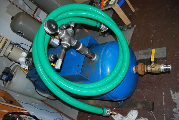

              Dude, that is SWEET set-up! I love the vac/compressor, that's the first time I've seen that on a sucker tank!
              fwiw, I know a couple people using CHEAP venturi-style 'vacuum makers' from HF. Just blow compressed air thru it and it pulls a vac in your tank! Not terribly efficient, but low-cost if ya already have an air compressor. I also know a couple folks using vehicles' vacuum system to 'charge' tank (gas and diesel trucks).
              If ya haven't collected this way yet - HOLD ON! OMG, that 1.5" hose (??) will slurp up crisco on a cold day, but will pull 90 gals of liquid VO in just a couple min's!!!! I would consider a a valve, then a peice of PVC or similar on end of hose. This solves the problem of hose coiling up, making it a PITA to get to bottom of drum - and makes it possible to suck from the top-down w/only one person. You'll see what I mean... Also, my friend Professor over at frybrid added some 'hangers' for his hose to the side of his tank - very cool!

                It's 2" hose and we're making a sort of wand to dunk down into the oil. My biggest obstacle is going to be loading and unloading the tank into the bed of my truck. My Queen has been pretty supportive of all my madness but I don't think she'll have the onions for heavy lifting. I'm thinking of some straps and a chainfall

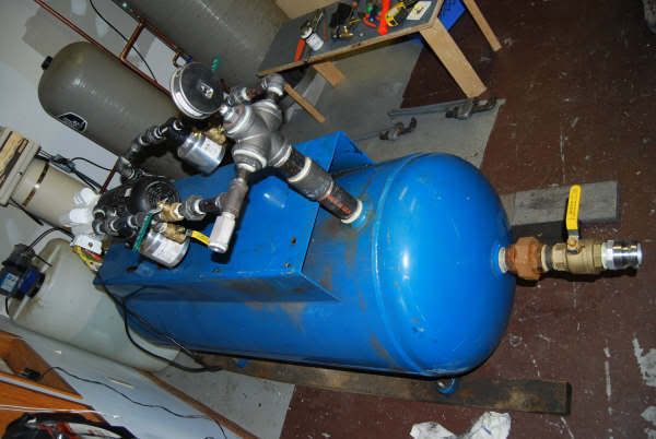

                  How do you plan on toting this around, on a trailer? Hell it's probably sturdy enough to just mount an axle underneath it and stuck a hitch on the front
                    That's a good idea...

                        An associate of mine has a similar setup for pick up in remote locales,he mounted his with 2 inch square stock to the reese hitch.He bought a $20 grill cover,everone just thinks he's ready to go tailgating..................
