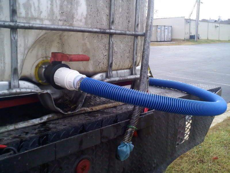

        I have a Honda 4stroke 1" water pump I use for collecting. Not cheap, but extremely reliable and very effective. It is very small and light, and not terribly loud when primed and pumping... Probably 20gpm at 60-70*, faster when warmer/slower when colder.
        It has a 1.25" 'pool hose' to a 1" PVC pipe on suction (w/valve to maintain prime!) and I use a 1.5" discharge directly to bottom of tote when collecting at home. On the road, I use garden hose on discharge and have used 150ft before!!
        I also have a 3" trash pump. I'm all gimped up after breaking my back, so it is too cumbersome for me to load and unload and when I used the 3" suction hose - OMG did that sucker move oil! 275gal in under 2 min's! It was terrifing collecting - any mess would have been BIG. I loaned it to a friend and he has 2" hoses with a 1" 'wand' on suction end I think. Should be much more safer/managable this way - we'll see! I think a 2" pump would be just right...
        I swear the vacuum sucker is KING though. By far the safest, cleanest AND fastest way to collect. Maybe the cheapest method too, if you are resourceful! (free tank, free a/c or refrig compressor - just buy fittings and hose!)
