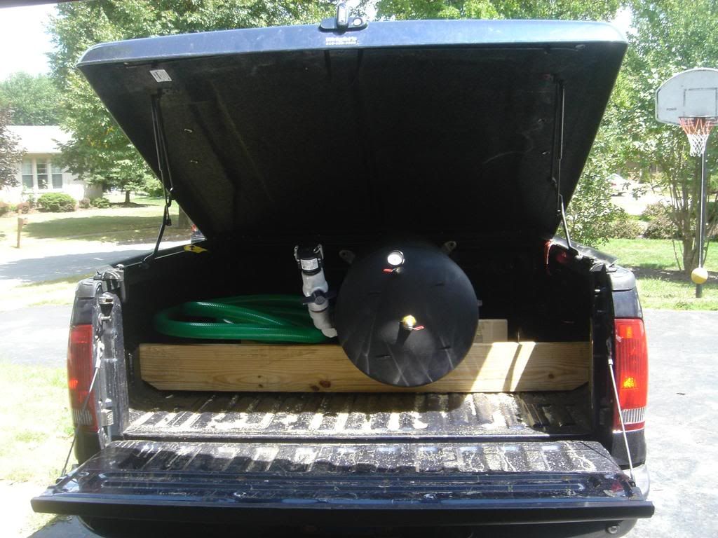

                  I went the air compressor route. I chose a 60 gallon simply because I could get it to sit under my taneau cover. The tank had like 6 different ports on it to chose from, including two 2" ports which REALLY make good suction line ports. I think a two inch hose will suck up oil 5 times faster then a one inch.
                  You shouldn't have to do ANY welding if you go the air compressor tank route.
                  Check out my thread for details. There is even a video at the end showing 50 gallons getting sucked up in about a HALF a minute!
                  Ok, Here is the start... I picked of this bad boy today: 60 gallon compressor tank. It is a little bigger than i planned. It needs to live in the bed of my truck under the bed cover. That gives my roughly 22 inches. My plan is to use the big 2" (I think it is 2") plug opening, elbow out to a...
