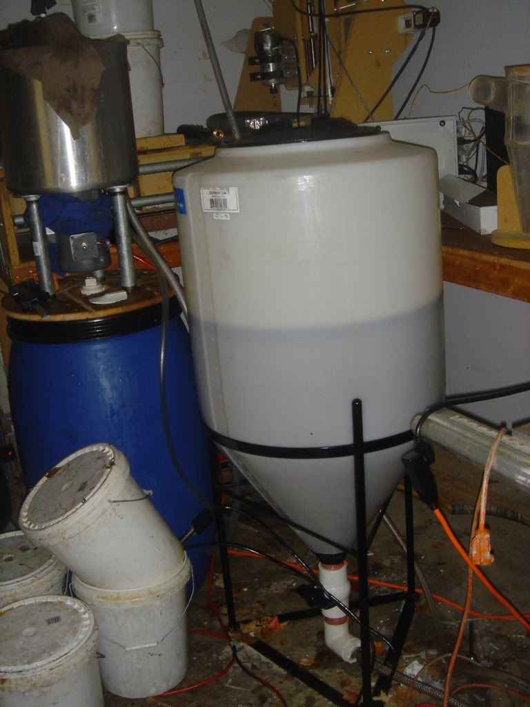

          I tried the mist washing thing last fall for the same reason (I was spooked about lye)...
          I bought the reactor tank below. and a couple of sizes of mist nozzles. I don't think the oil was warm enough though cause the water didn't completely separate and, when i turned the pump on, I ended up making a 50 gallon milkshake. I had to add TONS of heat to break the emulsion. I was a big messy pain in the A$$ and ate up tons of my time.
          I haven't given up on it, but it is certainly a summer time project.
          2005 F350 Harley: Heat Induction Hood, ARE Bed Cover, DashHawk, MBRP turbo back, cat delete, SCT: Tunes by Spartan, Exhaust Sound Videos HERE
            Fastcote, the oil MUST be warm - I think 140-150 is prolly minimum. High fat content oil may need more! The water should also be warm to avoid cooling the oil. It is easy to experiment w/small quantities. I use the little 'hot plate' single burner stove I use for HPT. Heat a soup can 3/4 full of VO and use spray bottle (window cleaner works great) to mist water over the oil...
            You are very correct, mist washing bio-d is MUCH more forgiving!!
              ya, I managed to make it work in small batches.
              The big poly cone tank like in my pic have relatively low max working temps (like 120-140) so I tried to error on the cool side. apparently it was a BIG error!
