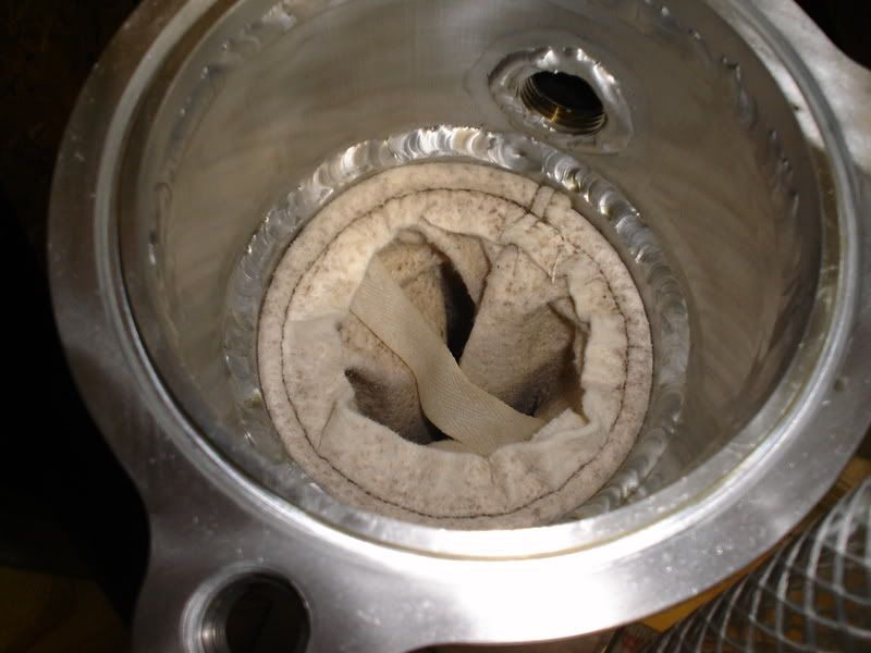

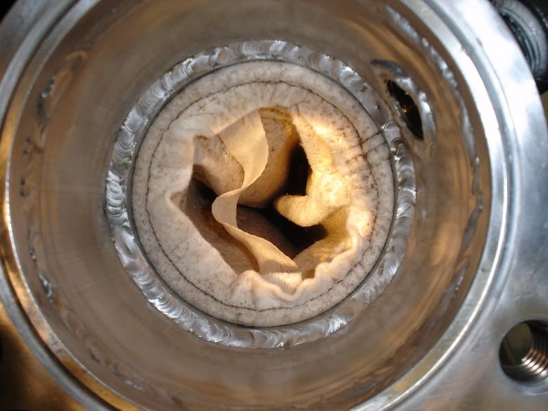

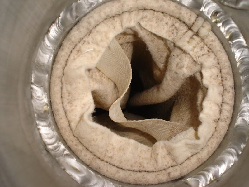

    Since there has been some discussion of the canister type filters and their life lately, I thought I'd post up some pics of mine when I checked it last week. I have put about 250 gallons through it to date and figured it would be quite dirty.
    However, I was pleasently surprised. Hardly any crud to speak of and the filter basically appeared to just be an "off-white" color.
    Anyways...here's the pics...
    Thanks!

      They're 5 micron...or at least that's what I ordered from McMaster. I verfied it the other day, but I'll check the receipt on them when I get home.
      I let it run an hour or so before I put it in the truck...should be around 20 cycles through the filter for an entire 40-50 gallon batch of oil.
      I know, it's got me stumped as well.

        Clay, I checked them again this evening...they're 5 micron.
