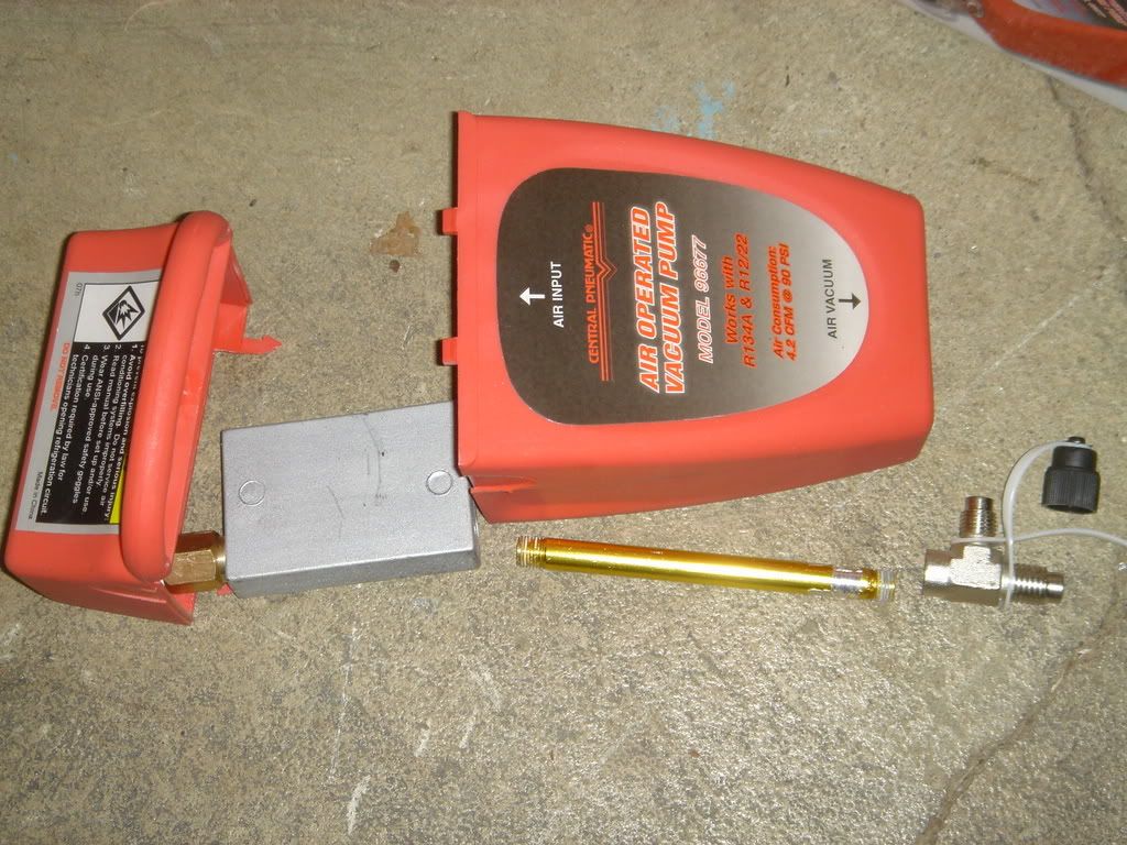

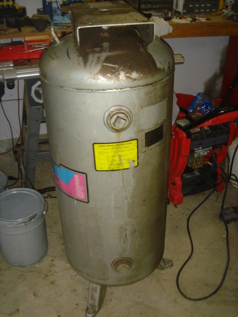

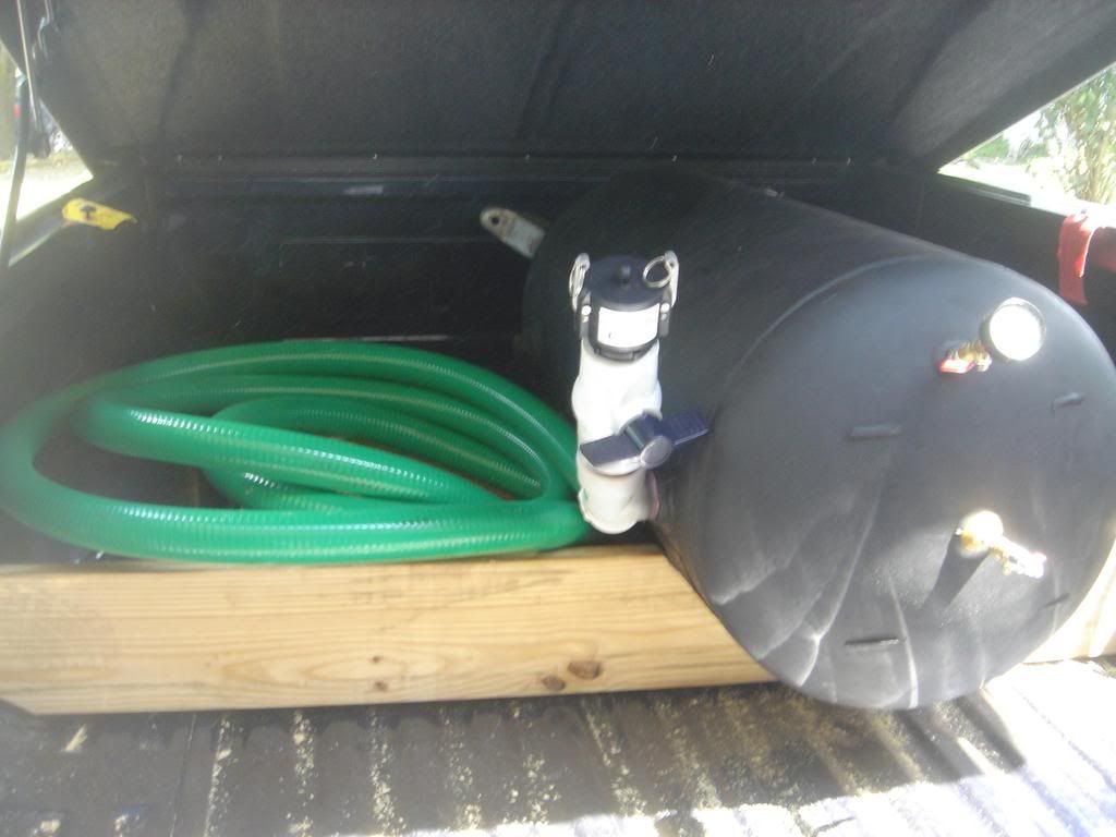

For those that don't want to read through all five pages (most of you likely) here is the gist of it:
crappy old 60 gallon compressor tank.
PLUS
Cheap ($15) Harbor Freight compressor driven vacuum pump.
PLUS
a couple of quick connect fittings
PLUS
Big A$$ suction hose (2 inch by 20 feet)2005 F350 Harley: Heat Induction Hood, ARE Bed Cover, DashHawk, MBRP turbo back, cat delete, SCT: Tunes by Spartan, Exhaust Sound Videos HERE
Finished product
http://s304.photobucket.com/albums/n...VacuumTank.flv
Vacuum tank in action. That's ~50 gallons of cold oil in about a HALF A MINUTE!Last edited by FastCote; 10-01-2008, 12:35 PM.2005 F350 Harley: Heat Induction Hood, ARE Bed Cover, DashHawk, MBRP turbo back, cat delete, SCT: Tunes by Spartan, Exhaust Sound Videos HERE
how much time involved to build 250 gallon version?.........greasy2000 7.3X V3 So much fun,so little time,Support small Oil,burn WVO,Free and greasy down the road I go!!!!!!!!!!completely self sufficient and proud of it. (Wood furnace.....X.......solar pontoon....solarsheat twins this summer.....I don't Know much.......I'm just a hillbilly with too many guns..............
It's all about how good a vacuum you can pull. Absolute is just under 30" mercury (i think). The better your vacuum pump, the closer you can get to absolute. As you can see from my links, I got the cheapest pump arrangement I could get. It uses my air compressor through a venturi to pull vacuum. this is neither portable (I have to do it in garage), quick (takes a good 15 minutes to get down to around 27". exponentially longer from there), not efficient (I am sure compressing air using a cheap sears compressor, then blowing it out at 8 cfm is not the best method).
All that said it works and it is easy. If you look at the pic with the venturi, you can see it has quick disconnects on it. On the tank, I have the mating connect. I plug the venturi on to charge vacuum, then take it off and plug the compressor straight on to put a little (LITTLE - remember that) pressure. Crack open the suctiion hose valve and blast it right into the slop oil drum.
I actually used this in reverse once. The video you see is a drum full of oil with a gallon of boil-out (lye) in it. after shooting the video, i charge the tank with a little air, drove to Dairy Queen, and blasted it into their oil dumpster. It actually SMOKED as it came out. Back to the LITTLE pressure part. I put too much in and when i cracked the valve it exploded out and sprayed the entire building down with crap oil - OOPS!2005 F350 Harley: Heat Induction Hood, ARE Bed Cover, DashHawk, MBRP turbo back, cat delete, SCT: Tunes by Spartan, Exhaust Sound Videos HERE
I built the sucker tank with a 420# old propane tank. I used 1-1/2" hose and was able to score a refridgerator compressor to pull a vac to 21 hg. I pulled about 60 + gal of thick softserve looking stuff this morning in 20 degree temps in about 5-8 min. I saw the power of a sucker on oil via utube, but am more impressed with the power to pull in the cold temps. All I can say is holy suction!!2002 7.3 Excursion Limited V3 w/40 gal RDS Tank, +50 gal or 100 gal aux cargo tank,
