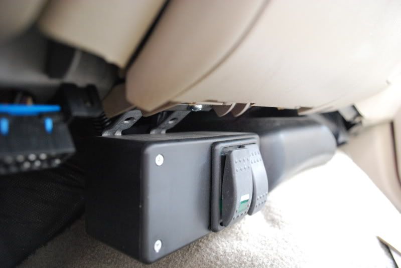

    PDX, I put mine just below the dash, just to the left of the trans tunnel.
    Here's a pic...
    It's basically just a Radio Shack project box that I cut out to fit. Fabbed up a couple little custom brackets and mounted it to some of the metal that supports the dash.
    I really didn't want to cut up the dash so this was the best option for me.
    Hope this helps.

        PD, unfortunately, that's the only one I took. When do you need them by? If you want, I can try to snap some pics tomorrow of how I mounted the box to the dash.
        As far as modifying the box, I just cut out the back to pass the back half of the switches through. I tried to keep the hole as small as possible while still getting it through there.
        On the cover I just traced out the mounting trim ring that the switches go in on the front and used a Dremel tool to cut it out.
        Let me know if you have any other questions.

                    PD, here's a couple shots again of my switches. They better show how I mounted them to the bottom of the dash. The metal "strap" you see attached to the back of the box is something I had laying around. Not sure that you are familiar with it, but it's the same type of strap they use for securing aftermarket radios at the rear of the radio. If you've ever bought a new one, they usually give you about a 6" long piece of it in case you need it. It's similar to pipe hangar strap, but thicker and much stiffer.
                    I just cut a couple pieces and bent them to the shape that I needed them. You can see in the pics, that I just used some small screws, washers and a nut on the back side to fasten them to the metal behind the dash. Same thing on the back of the box. Just drilled a couple holes and ran some small screws threw there with washers and nuts on the back.
                    Hope this helps. Let me know if you have any other questions.
                    Thanks!
                      I think I had to drill a couple holes in the metal behind the dash by the way...just remembered that.

                          thanks Marv. That is a great clean looking install. I think I am going to have something exactly like that done.
