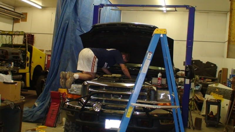

      After we got the tank mounted we moved to mounting the V3. Dan was still under the hood at this point messing with the fuel ports and fittings.

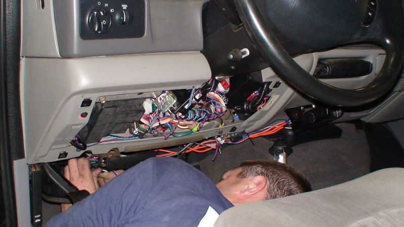

        He spent a lot of time in this position as well. It was very awkward for me to work under the dash like this.
