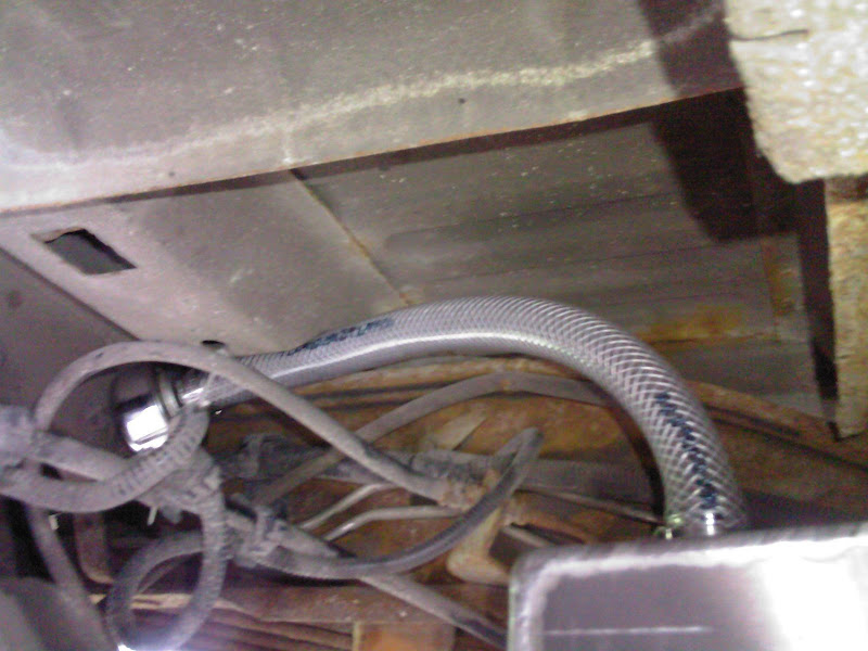

                here's a picture of what I did, for anyone else that might be having the same problem
                That's about 16" of 1" ID braided PVC hose, with a standard valve cover breather on the end. The breather has a 1" male stub on it, so it makes the assembly very easy. A couple hose clamps and zip ties, and you're done.
                It's not dripped a DROP since I installed it, I even filled the tank and had no issues.
                thanks again for the suggestion grady

                  well 5.0,
                  Went out this am and my rear axle is really clean after a WVO wipedown !!
                  I have to drop the tank anyway so I'll do your vent mod then.
                    mine seems to be working, just have to make sure not to overfill the tank like I did last time, cause it still finds it's way up the tube

                        I used one almost idenitcal to this one: http://store.summitracing.com/partde...5&autoview=sku
                        It's a push-in style breather with a 1" port on it, which is the same size as the vent fitting on the tank. I think PepBoys would have one.
                        I got the 1" PVC hose from Lowes.

                              I was able to do the fix without dropping the tank. The only time I've had any leak since is when I way overfilled the tank (oil all the way up the filler tube), and even then it wasn't as bad as the leak when the vent breather was directly on the top of the tank.
