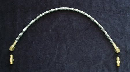

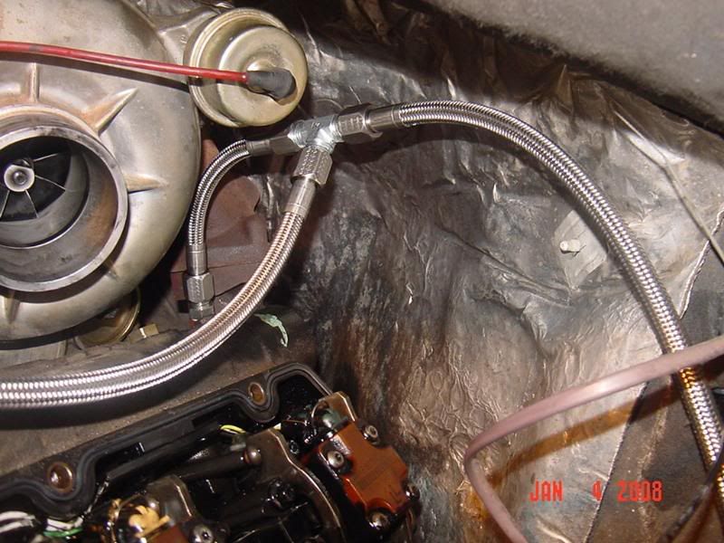

                      Another though is to use a steel braided line from the module to the sender. Then you could remote mount the sender somewhere else out of the way.
                      I did this on my Camaro with the oil pressure sender. I didn't want it near the heat of the header nor did I want it subject to all the vibration of the motor, so I ran a line from down below and mounted the sender up top in the engine bay.
                      My only concern would be how those lines interact with the VO....
                      Just a thought...

                        I'm using teflon-lined SS braided hose for all under the hood VO plumbing and had same stuff (only smaller) hooking up mech. fuel pressure to 'isolator'. No issues w/VO.
                        somethin' like this would do ya...
                        heres what my fuel lines look like
