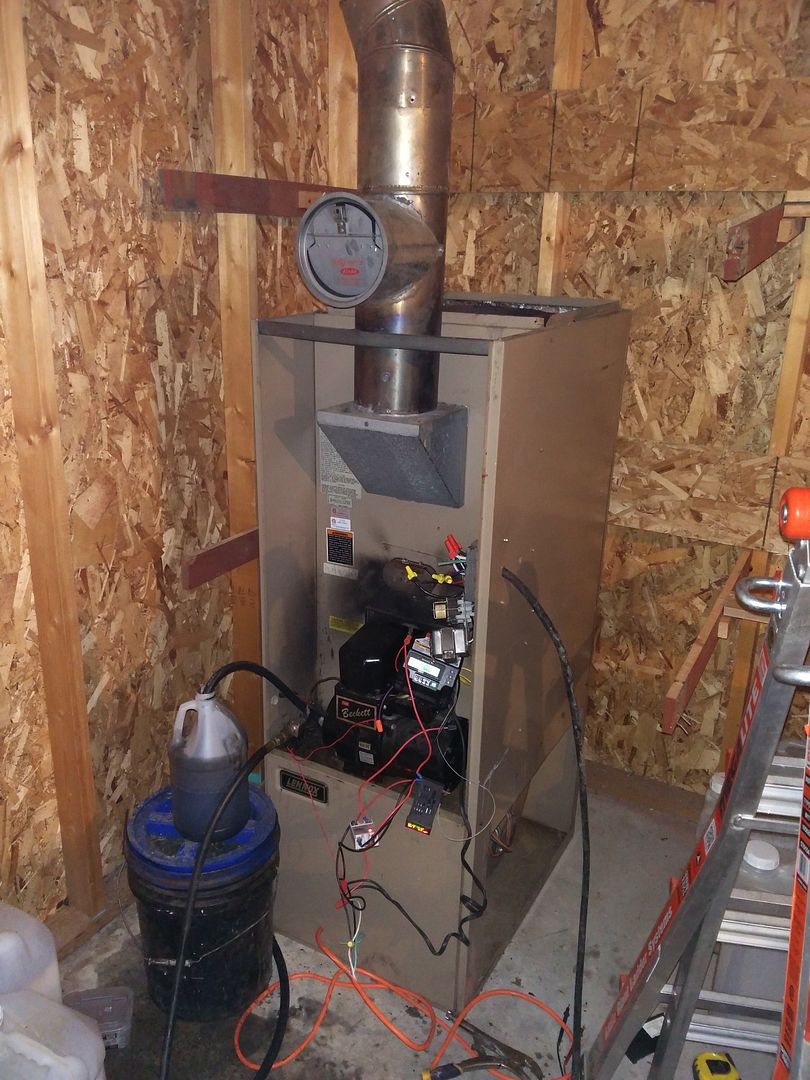

          Here's a photo of my oil furnace running on WMO and WVO. The furnace is temporary until I get the boiler all setup.

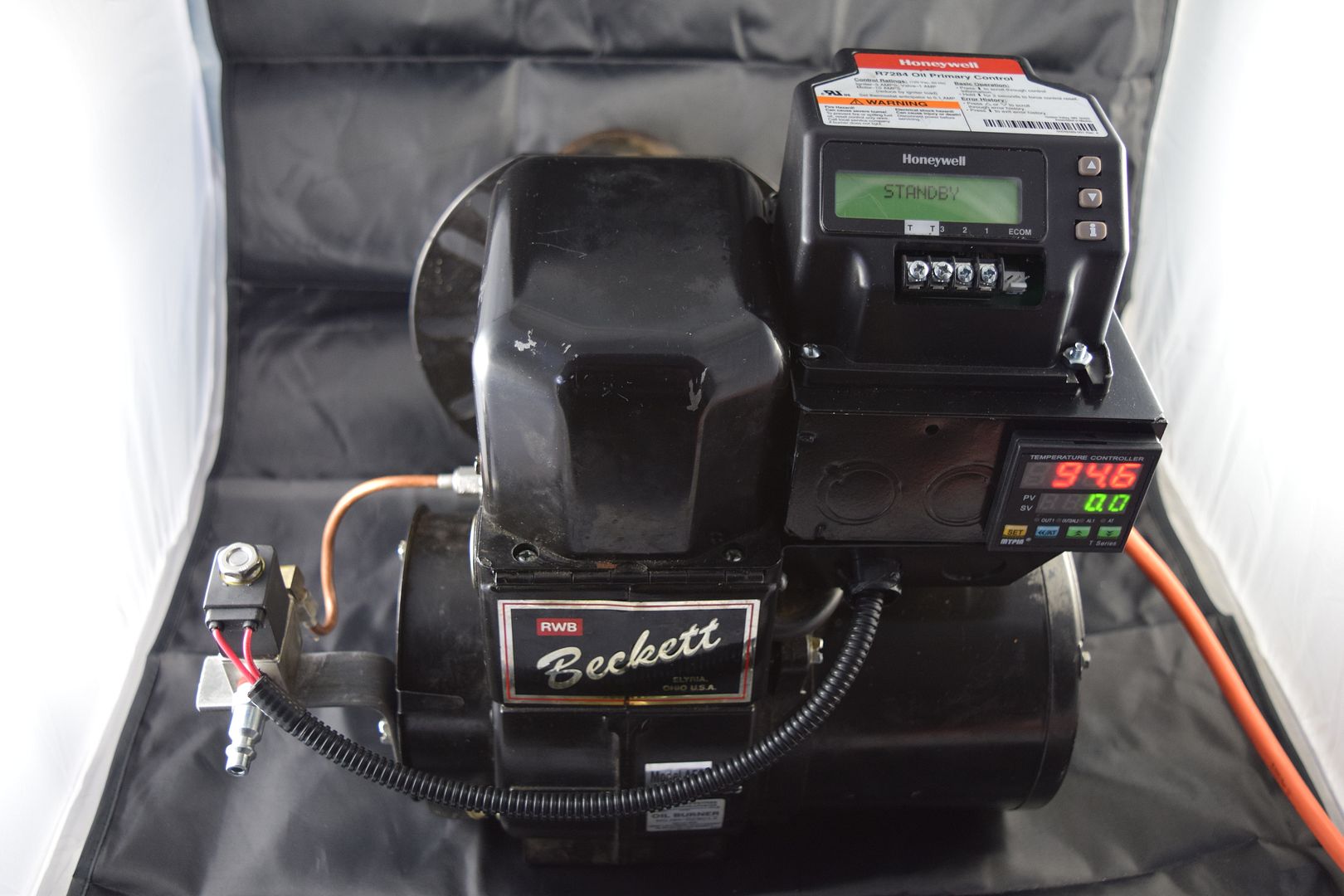

            Primary control before paint.

              I know you have a way bigger shop than me so space isnt as much an issue, but what are the dimensions of your burner unit?
              You've seen my garage, its jammed with shit. I'd love to burn some of my oil surplus for heat but I'm worried about the space I'd need to carve out.
              If you are building a compact, automated oil burner... I'm a buyer.

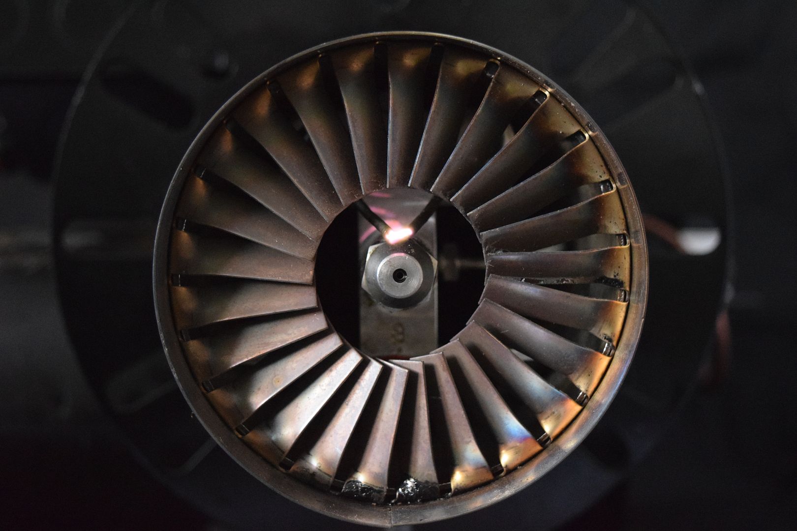

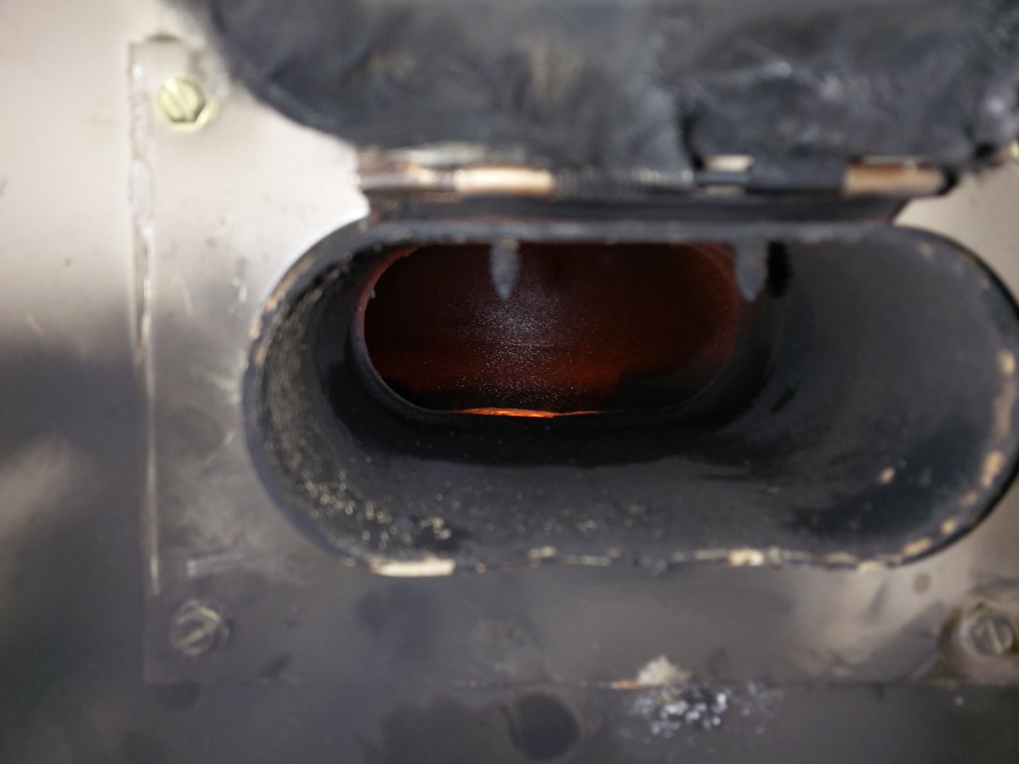

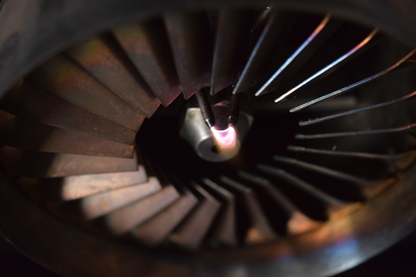

                Here's a better shot of testing. I'm going to be using a tote for the fuel tank so that will take up the most room.

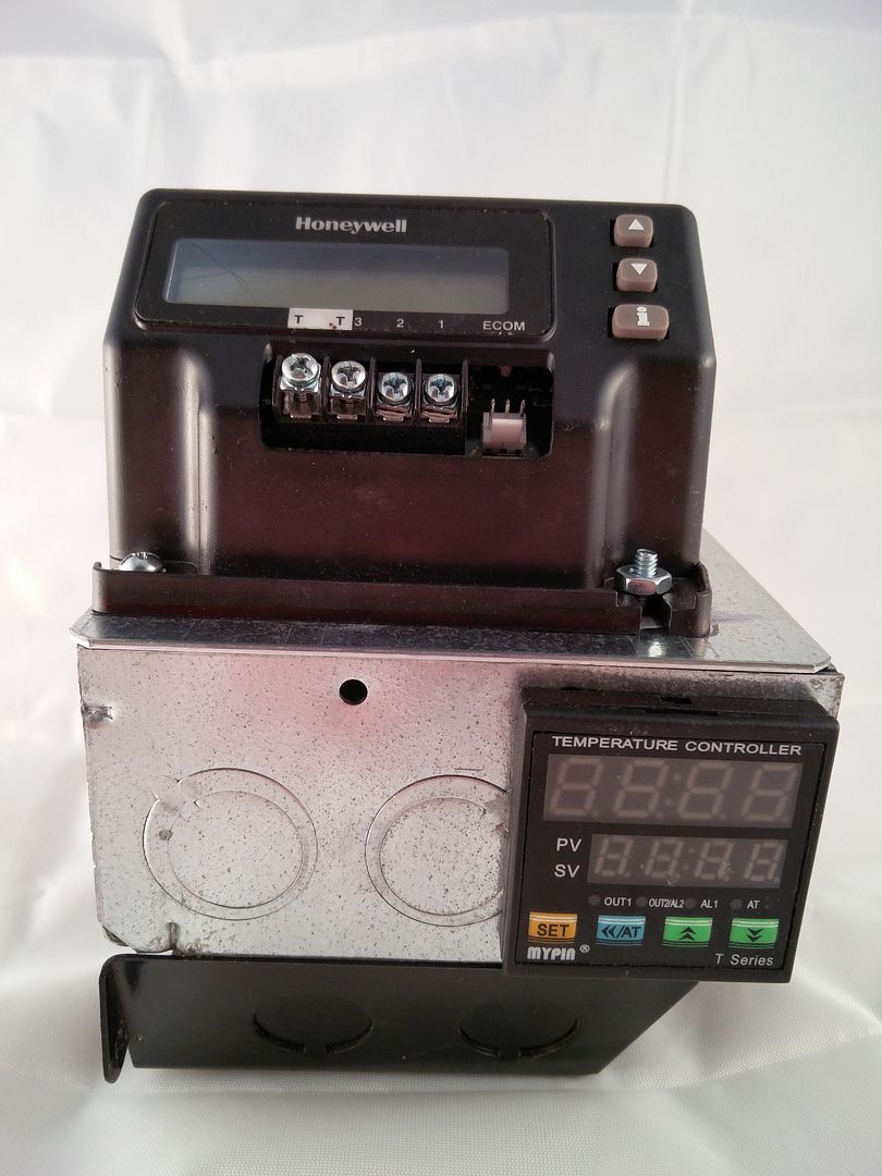

                      Finished the wiring today.

                        In the photos you can see the air valve on the left. The primary control is on top. The PID on the bottom controls the temp of the nozzle heater block. I have a 1.5 GPH nozzle that is capable of 150,000 BTU.
                        Heater block comes from ckBurners.
