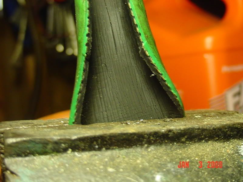

      This is what some of the Weatherhead 250psi diesel fuel line looked like after just several months in VO service under the hood! No failures, but sure freaked me out. One of these lines fail and ya need a tow truck... (btw, the exterior of these hoses looked fine)

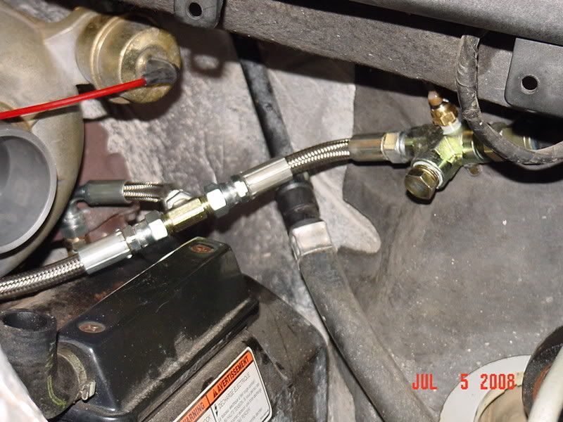

      This is my 'permanent' solution - not cheap, but will easily last FOREVER. PTFE-lined SS braided hose with JIC swivel ends:
