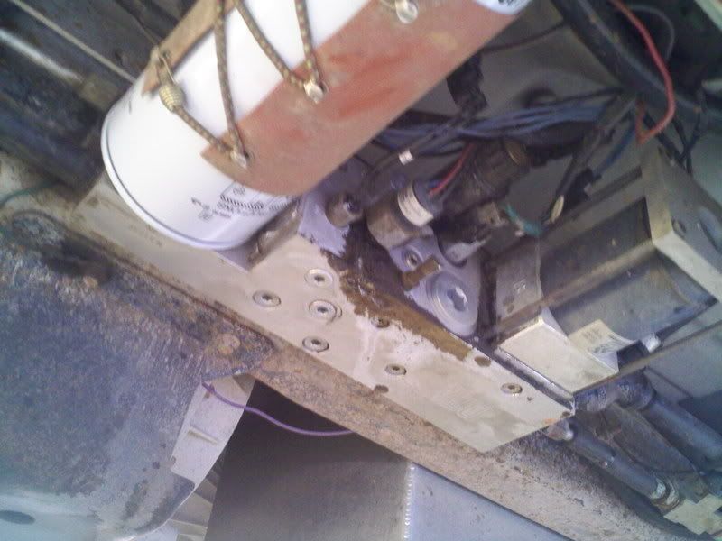

                              Is it worse than this?
