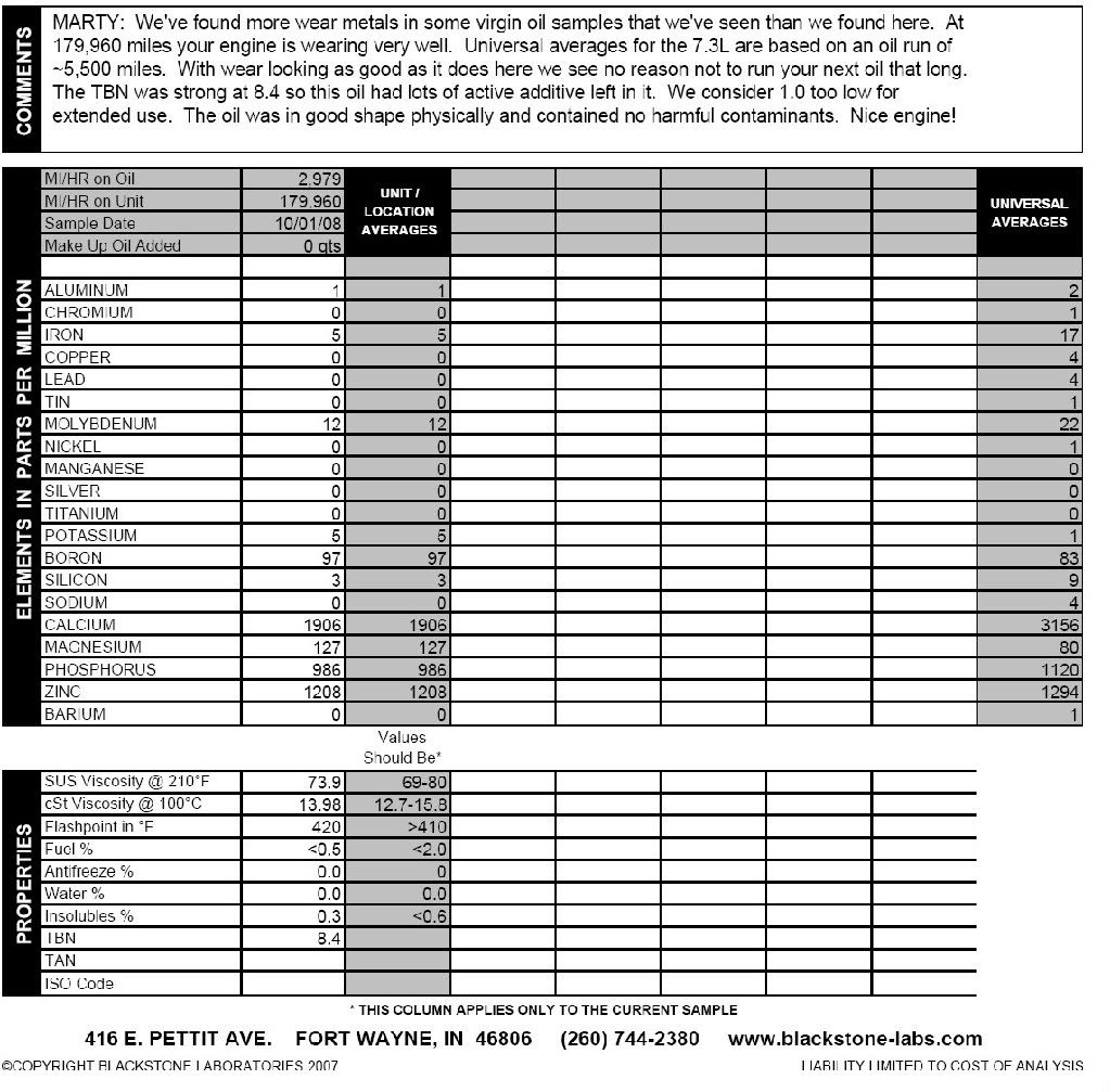

                                Here is my latest report.
                                I suck at adding pics. I can never get them large enough to see.
