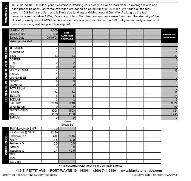

      i ran one. here you go, about 2500-3k mi on oil
      EDIT:
      crap cant figure out how to remove personal info from pdf...
      anyway they said there is 1.5% fuel in the oil. standard is <2.0% so they say it's perfectly normal for 6.0

        Wilson, is there an attachment with the post? I'm at work and can't see it apparently.
        So, was it good or bad results?

          lol.
          Take a print screen and cut out that stuff in paint.
          Your post was enough info for me though.
          1.5% fuel in the oil. BUT is that fuel WVO or #2? Would 1.5% of WVO react differently than #2? If so, would 1.5% WVO be above the acceptable standard for WVO?

            Yeah Wilson, the post cleared it up for me as well. Sounds pretty good.
            Also, in Adobe, you can use the picture select tool to "snapshot" just the info you want. It's the tool that looks like a little camera. Just select it, click at one corner of the info you want, drag the box around it and then release the button and it'll copy it to the clipboard I believe.

                I did snap out the personal data and it was too large for attachment.
                I will upload it to web and post..

                    try this
                      I purposely did NOT say I was burning wvo.
                      I will on my next sample.
