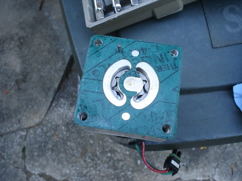

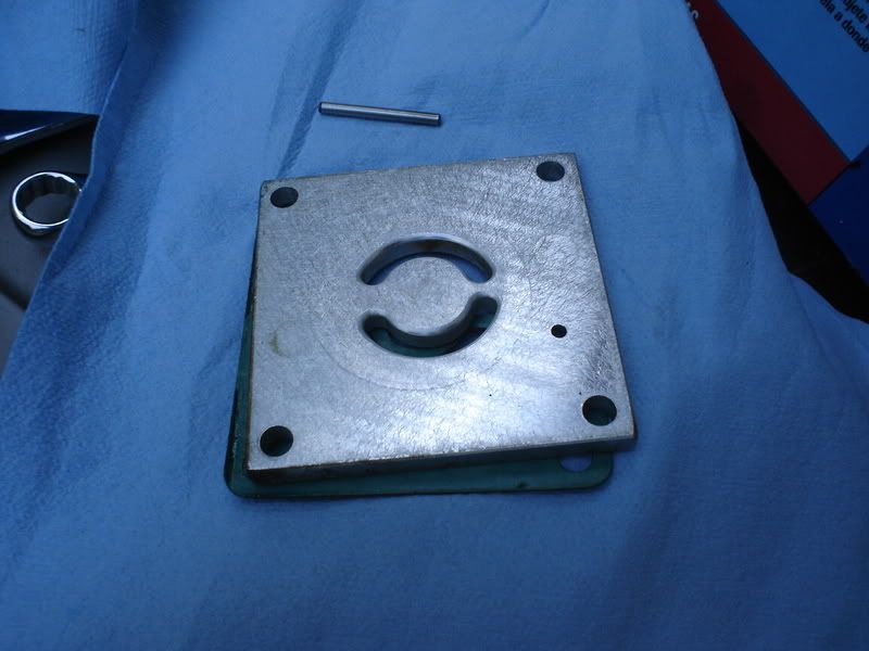

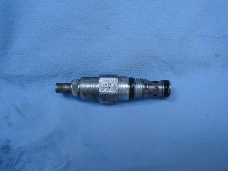

    After it was all said and done, I cleaned the pre-screen (looked good), pulled the pressure regulator, cleaned it with compressed air (looked good) and checked/reset it to the factory setting. The other suggestion Jason had was to pull the pump and inspect/clean it. So, I got it off there and snapped a few pics while it was off. Figured other folks would want to know what all is in there.
    First, the regulator...
    Pump...
    Intermediate mounting plate...
    I'll put a pic of the gasket in the next post....board limits on pics in a post won't let me put it here.

    Also, a few notes on the pump. You'll notice on the pump face, that there is an o-ring groove for sealing. The o-ring is not in the pic, but be sure you have this little jewel in there when you put it back in. First time around, it washed out and into the drain pan while I was working. Never noticed it until I dumped the pan into a trash cube. So...after a few aggravating minutes, I got back under there and pulled it back off and made sure the o-ring went in as it should. If you're like me, you'll have a flood of oil coming out, so it's easier than it seems to let that thing fall/wash out of place. And it'll almost immediately seep oil if it's not in correctly.
    Also, make sure you have the top plate turned around correctly before getting all of it together and starting the screws. Trust me, it'll aggravate you when you realize it's backwards and it'll all have to come back apart for a third time.

    Here's a shot of the gasket...
    Goes between mounting plate and the module...
    Also, note the alignment pin in the above pictures...make sure you have this too.
    All pieces are pinned, so they only go together correctly one way.

                  My pressure regulator is set at all the way out and 2 1/8 turns back in, just as Jason told me. Clay, do you have any idea what yours is set at? Ever check it?
                  I also wondered if there would be any issues with upping the pressure via the regulator. However, I'm not sure if turning it farther in increases the pressure of if running it farther out increases it. I'd assume turning it in, but could be wrong.

                      never checked mine...it was preset to that pressure when i got it and i haven't touched it. Turn it another 1/4 turn in or out and take a reading on the schrader valve...would be easy enough.

                        I may adjust it up closer to 70 psi.
                          run it to 75...filters will last longer.
                            Roger that...will do!
                              Well, adjusted the pressure this evening. Another quarter turn netted me about 10 psi.
                              So, now it's setting right at 75psi. Headed on about a 600-700 mile trip tomorrow, so we'll see how it goes.
                              By the way, you turn the regulator clockwise to increase pressure.
