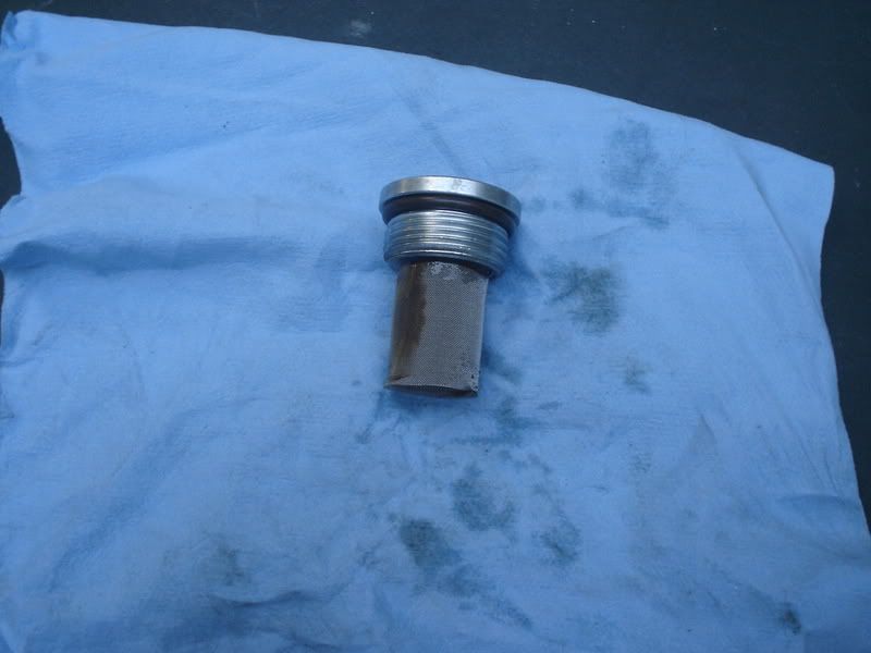

    Over the past couple days, the green light on the switches has been flashing on and off a bit. Noticed yesterday that it would come on and then go off. It'd try to come on a couple more times and then it'd just stay off.
    So, I manually reset the system by turning it off and then back to automatic a couple times. After two or three times, the system would come on and stay on. My first thought was the pre-screen (which Clay also recommended), so this afternoon I pulled it out and checked it.
    Here's what I found:
    Not a whole lot there. So, I cleaned it up a bit and put it back in the module. After I got done, I then checked out the drain pan I had used. While I cleaned the prescreen, I let oil drain out of the opening for about 6-8 minutes. I guess during the drain, a number of metal shavings made their way out. Here's a shot:
    First couple times I fired the truck up, the system still did the same thing. On and then off. Reset and then it's good. However on the final drive home this evening, it came on and stayed on. Never really cooled off however, so I'm thinking that the higher temp of the oil aids in it flowing through the screen - lower viscosity means it'll flow around any debris. I think this was what allowed it to work after resetting prior to my cleaning of the prescreen.
    Anyways, just wanted to post up my results. I'm going to see what it does tomorrow and then change the Donaldson if I need to.
    Thanks!
    Doesn't look too bad i don't think...maybe we were way off. The donaldson maybe plugging. If so, keep track of milage ont eh second one and if it fails as fast, you will need to look into your filtering procedures i would think.
        Well, as luck would have it, I was late getting home this evening, had somewhere to be and I didn't get to change the Donaldson. However, after cooling almost two hours, I fired the truck up and the light came right on and stayed on. Over the past couple days it hasn't been doing that.
        So...I'm gonna go one more day (don't really have a choice, gotta work) and change it tomorrow afternoon. It still seems to operate fine when the oil is up to full temp, so I'm hoping it's got one more day in it.
        And you're right...if the filter change doesn't do it, I'm gonna troubleshoot a couple other things and then re-think my filtering.

          No problem on the pics. Well, first off I'm just gonna change the filter. I'm pretty comfortable with my filtering at the moment (filter has almost 2800 miles on it and it's the first one - catches all the manufacturing junk from the tank build) so I'm hoping there won't be anymore problems with a new filter.
          If that doesn't remedy the issue, I'll check the temp and pressure switch and then look into cleaning the line from the tank to the module. If I need to clean it, I'll probably try compressed air first.
          Not sure how a person would clean all the passages in the V3 - not sure how all the passages run. I'm sure Jason or James could provide the answer though.

                I dont see any reason to have to clean the V3 passages, if something got in there that is large enough to block a line, it will likely lodge in the rubber hose. If it makes it to the V3, it will stop in the prescreen which you already checked.
                Marv, changing the filter before taking a pressure reading is like eating a steak when your not sure if you hungry. Check pressure first...it will take 2 seconds with a tire gauge and it will take the guessing out of the scenario.
