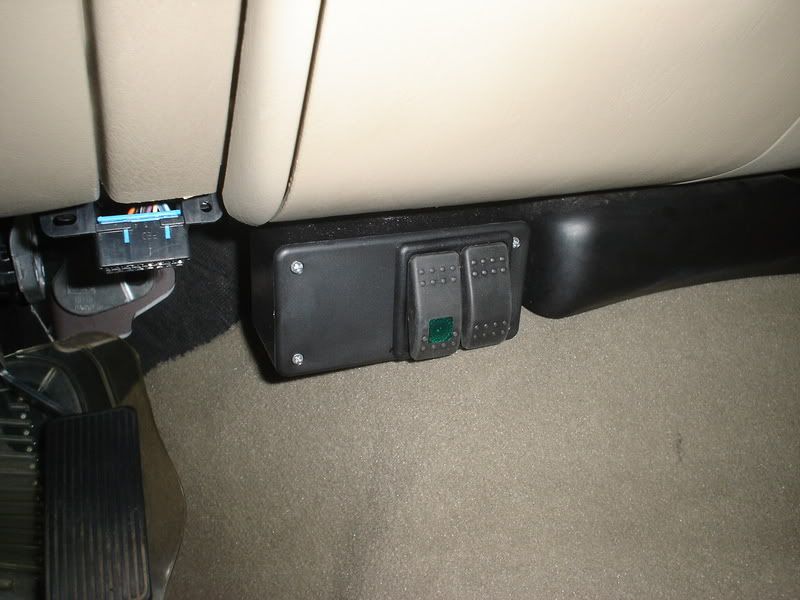

      Geo, I was the same way you are - didn't want to cut the dash.
      I decided to go with a project box from Radio Shack and mount them down below the dash - just to the right of the OBDII port if you're sitting in the truck.
      I snapped a pic this past weekend of how it turned out. I was really happy with the result.
      I'll post the pic this evening both here and in my install thread.

        see my post in the excursion forum here...
        follow the link and see the pics. very clean an minimal cutting. looks better than those pics in person since i put a dab of epoxy on the side.

              Gonna bring this back from the dead a bit since I promised to post up a pic of what I did with my switches. Finally got around to hosting the pic.
                Very nice! Is the project box attached at its top or some other way?
                    thanks,
                    I actually used some standard "L" shape brackets from Home Depot for the mouting. I bent them to the angle I wanted and just bolted (drilled and used little phillips head screws) them to the back of the project box. Right up above the box under the edge of the dash is part of the metal structure that supports it from behind. I had to drill a couple holes in it, but overall, two screws held it great.
