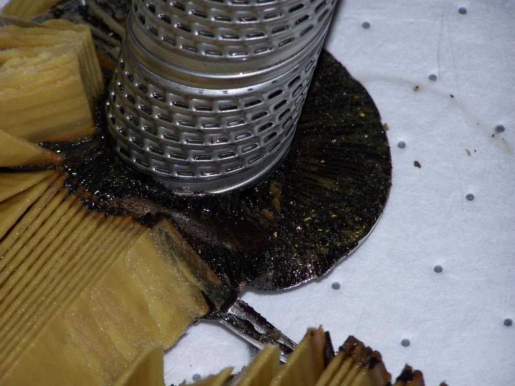

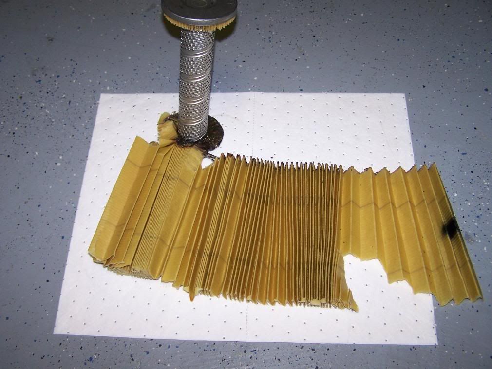

    Here is a pic of the Donaldson filter after 3,500 miles of vegie. I don't think this will be typical of everyones filter (my oil is very clean) but I wanted to take a look at it. The metal you may see came from me cutting the housing off. I also drained the oil to see if it would pass a hot pan test...and it did. As you can see on the last 2 pics the only crud is around the interior metal base. I did the HPT because I had read that the donaldson will catch some of the water. I am gong to wait until the green light starts flashing on the next filter then take a look at it.

    That looks pretty good to me. you could probably easily double the miles the way it looks I think I'll do that to mine when I change it.
