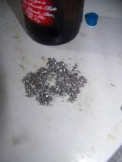

              Here too. Two words, Compressed air. I took out the EX after cleaning mesh screen again, I found a mesh ball stuck in passageway, used pic to get it out. Tryed flushing with motor, won't work. On test drive noticed slightly better pressure, I figured a restriction was the culprit, Thanks to James for calling me back Saturday( see you are a better trouble shooter over the phone than you thought!).
              Got back home, pulled screen out, then blew 100 psi into tank to clear line. Then blew the air into V3 fuel intake nozzle w/screen out & WALLA, out comes 20 grams of aluminum mesh. Poped in screen, turned her over & BAM back upto 70 psi!

                cool
                so you had aluminum shavings stuck in the rubber line? Or did it make its way into the v3 block and got stuck before the screen??
                good info, maybe a prefilter is a good idea? just need to make sure it's pretty high micron. Probably no less than 100?
                  Yes it was stuck in the V3 before screen. I may have had some stuck in rubber hose too, will find out eventually, but I blew out hose also.

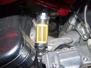

                      I prefer clear filters I can see, & therefore know exactly if I have fuel or not, without having to disassemble fuel lines.
                      Something like this:
                      Would have instantly let me know about this:

                        Yankee engineering
                        Use a Whole house water housing with a 100 or 50 micron sediment filter.On my truck I tucked it under rear ac motor.When there is a issue I can see it,I can change out that filter,in less time then the one i can't see inside,and save my money not being spent on Donaldsons toward a Racor pre-pre-filter.I think that would be triple-redundency......grease out
